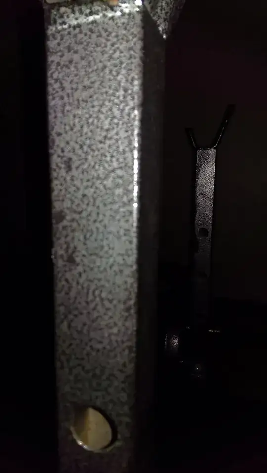

These are pictures of my old bench. Since the bench is still standing strong after so many years, I take something like its material would be appropriate for my use case. What do you call this kind of metal/coating, anyway? What properties does it have and is it difficult or expensive to produce/replicate?

The finish shown is a type of paint - "Hammerite" is either the name, or the brand name of the most popular/first version. It's presumably on mild steel. However, any automotive paint should work (think about it) - and COULD be cheap if you have a cooperative paint shop and you don't care what color it is (ie, they can spray some excess when they spray something else, so it's not a special job where they have to mix paint and clean the spray guns just for your tiny job.) Some shops will, some shops won't - all you can do is ask.

Normally gym equipment is powder-coated. in your picture, they have used an electrostatic powder coating process and finished with a sort of hammertone finish..

    • Your last option (and most cost effective) is to galvanize the metal. this results in a zinc layer being coated on all surfaces of the metal (inside and outside) your second photo looks like it has been hot-dipped galvanized. the galvanizing will look really shiny at first, but will form a dulled coating and will last for many years.. Galvanizing comes in two types
