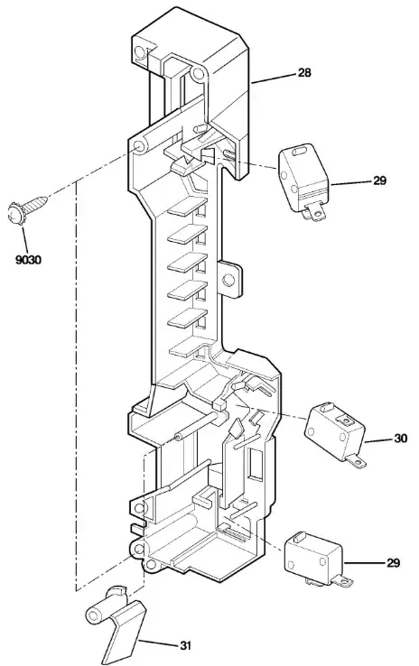

This particular model has three microswitches to detect the door being fully closed. enter image description here
If any one of them are loose or defective, it would cause the symptoms you experience. Each switch is pricey at $30 from GE or $23 from Amazon but there are many low priced sources (see comments below), so I would open up the appliance and have a look to see if a wire has come loose, or a switch is no longer seated properly. With it open, you should also be able to trigger the switch and see if it sounds like it is working correctly. With this type of switch, listening to it can successfully diagnose them 90% of the time.
If all the switches seems mechanically okay, then bust out a DMM and use the ohmmeter to see which one is not remaining closed when toggled.

The door interlock circuit is typically at least 3 microswitches which have to close/open in a specific sequence and arrive at a specific end-configuraton to convince the controller that the door was actually closed properly, rather than a crude attempt at bypassing the switches being made.
The switches themselves are normally very reliable (they are one of the nearly always salvageable parts of dead microwave ovens) but if the door-latch has worn or broken it may not contact them correctly.
In short, I suspect the sensors (switches) are probably fine, but the mechanical parts that actuate them are more likely to be the problem.
As for testing the switches, just check for continuity - the NO contact should be not connected until the switch is pressed, the NC contact should be connected until the switch is pressed, and both should change to the other condition when the switch is pressed. Pay attention to what wires are connected and where the switches are - it's typical for a contact to be cut off if not used, and which switch goes where (and which wires connect to it, where) are important for the whole business working correctly.

This morning I was all set to take the microwave apart and see what was wrong. I was preparing to unscrew the microwave from the cabinet above when I noticed that those screws were not tight. They have loosened so much that the microwave was hanging about a quarter of an inch below the cabinet.
This caused the entire microwave to deform. It was evidently deformed enough that the switches for the door no longer lined up properly all the time. With the door closed, I was able to raise and lower the front of the microwave to get it to turn on and off.
Rather than take the whole microwave apart, I simply tightened the three screws that attach the microwave to the cabinet above. Once I did that, the door sensors seem to work much better.
