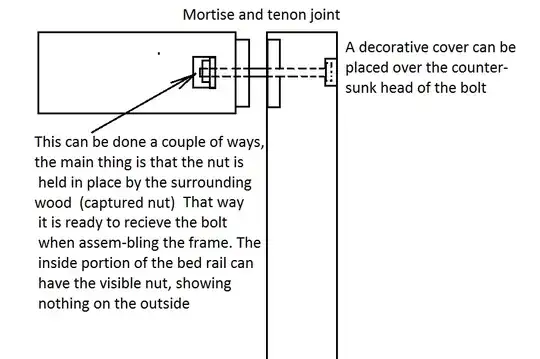

Edit 11/16/13 To assemble your bed frame, the M&T joints with captured bolts with nuts to hold the corners together with the legs.Captured nut Just as a mention, a good hardwood needs to be used for the assembly. regular 2X4, 2X6s and other similar materials used in the construction of homes will be too soft, and when the joints are put under stress SPF, Hem fir, etc is going to compress and loosen the joints. To use this material you need glue and screws to hold all this together. That is not an option for you I think?

  • I'm new to all of this, so I've never seen a sliding dovetail. It seems ideal -- what's the downside? Why don't people use it more often? – LoftyGoals Nov 16 '13 at 17:09
  • In your case, it would need to be stopped (the slot stops 1/3 to 1/4 above the bottom. A router table would make fast work of the slots and pins (2 different bits). You should seal the surfaces to minimize moisture differences through the season. You should still adjust the fit for the moisture content of the wood and the season you make them. Spring and Fall are the best, as MC is in the middle. Kiln dried wood is a requirement for this joint. – HerrBag Nov 16 '13 at 17:29
  • I revised the answer a bit, yes as Herrbag mentioned rightfully so the dovetail notches should not go all the way through. I tried my first sketch with sketchup as I have seen used here but still need to learn how to convert it. That drawing had the stopped cut, just couldn't get it out there – Jack Nov 17 '13 at 01:58
  • This is a fantastic answer, particularly the information about the wood that I didn't ask but really needed to know. I'm a little afraid I won't be able to pull off the wedged dovetails, but maybe I can use a combination of captured nuts and blind tenons. I'm also wondering if I can use a turnbuckle and cables to keep everything in tension, but I posted that as a different [question](http://diy.stackexchange.com/questions/35845/can-turnbuckles-hold-a-frame-in-tension). – LoftyGoals Nov 17 '13 at 06:00
  • There are 2 jigs that would be made to create these joints. that would eliminate the human error part, after a few test pieces are made. – Jack Nov 17 '13 at 14:25
