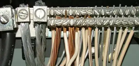

Look in the panel
Carefully remove the cover of the main service panel, and take a look at the wiring. Looking at the neutral/ground bus bars, is probably the quickest and easiest way to tell.
Copper and Aluminum Wiring
You'll notice in this image, there is a mixture of both aluminum and copper wiring.
