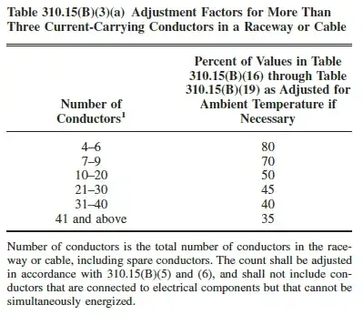

Article 334.80 tells you that you can use the 90°C column from Table 310.15(B)(16) for derating, but the final value must not exceed the 60°C column. If you look at Table 310.15(B)(16), you'll find that 12 AWG copper wire is rated at 30 amperes at 90°C and 20 amperes at 60°C.
Table 310.15(B)(3)(a) tells you that with 7-9 current carrying conductors, you'll have to derate the ampacity by 70%. So with the information from Table 310.15(B)(16), and Table 310.15(B)(3)(a). The math is quite simple.
4-6 current carrying conductors
30 amperes * 80% = 24 amperes
30 amperes * 70% = 21 amperes
10-20 current carrying conductors
30 amperes * 50% = 15 amperes
Which shows that you can have between 7 and 9 current carrying conductors through the bored hole, before the wires are derated below 20 amperes (from Table 310.15(B)(16) 60°C column). Since each 12/2 cable has 2 current carrying conductors, you can figure that only 4 cables can pass through the bored hole (2 * 4 = 8).

Where more than two NM cables containing two or more current-carrying conductors are installed, without maintaining spacing between the cables, through the same opening in wood framing that is to be fire- or draft-stopped using thermal insulation, caulk, or sealing foam, the allowable ampacity of each conductor shall be adjusted in accordance with Table 310.15(B)(3)(a) and the provisions of 310.15(A)(2), Exception, shall not apply.
Where more than two NM cables containing two or more current-carrying conductors are installed in contact with thermal insulation without maintaining spacing between cables, the allowable ampacity of each conductor shall be adjusted in accordance with Table 310.15(B)(3)(a).Article 310 Conductors for General Wiring
310.15 Ampacities for Conductors Rated 0–2000 Volts.
(B) Tables.
(3) Adjustment Factors.
(a) More Than Three Current-Carrying Conductors in a Raceway or Cable. Where the number of current-carrying conductors in a raceway or cable exceeds three, or where single conductors or multiconductor cables are installed without maintaining spacing for a continuous length longer than 600 mm (24 in.) and are not installed in raceways, the allowable ampacity of each conductor shall be reduced as shown in Table 310.15(B)(3)(a). Each current-carrying conductor of a paralleled set of conductors shall be counted as a current-carrying conductor.
