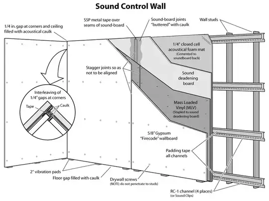

The safest approach is to actually cut the wall open and see what you are really dealing with. While it involves drywall repair and paint, it also doesn't involve heavy fragile expensive items being hung based on conjecture. While the wall could be brick, it could also be studs (steel or wood) with resilient channel (somewhat age of building and local building practices dependent) - one of the features of resilient channel is better sound isolation, which is good for a party (common) wall. But some places a party wall is nearly always going to be 18" or more of masonry for fire purposes.
The wall shown here uses resilient channel, which is what I was looking for an image of, but also some other techniques that may well not apply.
You may find that you can "see" the resilient channel (or furring, as it may also be) better changing the studfinder direction (turn it 90 degrees, and sweep up and down)
Sound control wall with resilient channel A piece of resilient channel on a stud
  • Does resilient channel have any impact on a masonry wall? – Tester101 Dec 10 '13 at 02:17
    It will still help reduce sound transmission, since it isolates the wall surface from the support. Depending on the construction of the masonry wall, that might or might not be noticeable (some transmit sound comparatively well, others block it well, and it would be hard to notice on one that blocked sound well in the first place.) – Ecnerwal Dec 10 '13 at 02:32
