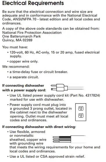

Dishwashers can be either hardwired, or cord-and-plug connected. Check the owners manual of the unit you have, but in most cases the decision is left to the installer.
From a random Maytag Dishwasher Installation Guide (PDF)
In newer homes you'll commonly find a 125V NEMA 5-15R receptacle supplied by a 20 ampere circuit, used to supply a dishwasher and disposer. In this case, the receptacle is typically installed in the cabinet under the sink. If you don't have a receptacle under the sink, it's not likely that the dishwasher is cord-and-plug attached.
The National Electrical Code, specifies that all outlets must be accessible. Because of this, a receptacle installed in a location that requires the removal of the dishwasher is not code compliant. i.e. If you can't find where the dishwasher is plugged in, it's likely hardwired.
Checking the wiring for the disposal, might give you some clues as to how things are wired.
You might also find This answer useful, when trying to figure out what you can connect to the circuit.
