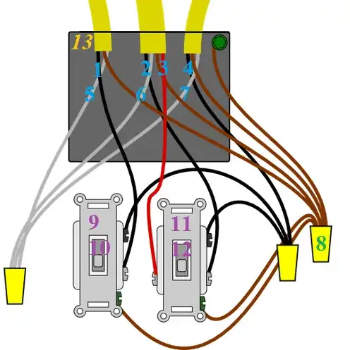

Suppose one is doing junction box fill calculations for a typical NM-B installation such as the one shown below for a switch box with one normal and one three-way switch. Which of the wires count towards conductor fill?
example installation

So how many conductors, and how many equipment grounding conductors are present in the box shown here?

  • You've got eight conductors. – Edwin Dec 20 '13 at 23:41
    I get 7 + the single grounding allowance, or 8. Don't be foolish though. Don't stuff it so full of pigtails and long leads such that the wires are really packed in there with little free air and pushing everything in could displace or damage something. – bcworkz Dec 21 '13 at 03:02

Please see this answer, for more detail. Basically if you have equipment grounding conductors enter the box, you add 1 fill unit.
Example Breakdown
In the example you've provided you have 12 if it's a box without internal clamps, and 13 if it has internal clamps.
Current Carrying Conductors
    Ungrounded (hot)            4
    Grounded (neutral)          3
Equipment Grounding Conductor       1
Clamps  (maybe)                     1
Devices                         2
                               x2
Total                               13
It requires yet another section of the code, but I think you are actually low.
The EGC is clear - 1, at the biggest size, and done.
Current-carrying wires (hots and neutrals and travelers) count once per wire.
But I think there is another paragraph (or sentence) which indicates that a "device" in the box ALSO counts (2 each.)
From Tester101's resonse to another question (but I think he's just quoting the code here)
Clamp Fill
  • If there are any internal cable clamps, add 1 (not 1 per, just 1).
Support Fittings Fill
  • If there are any luminaire studs or hickeys, add 1 (not 1 per, just 1).
Device or Equipment Fill
  • For each yoke or strap containing one or more devices, add 2.
So you have 8 count of wires, but 12 count (at least) of "fill units" - 13 if you have clamps.
