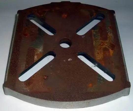

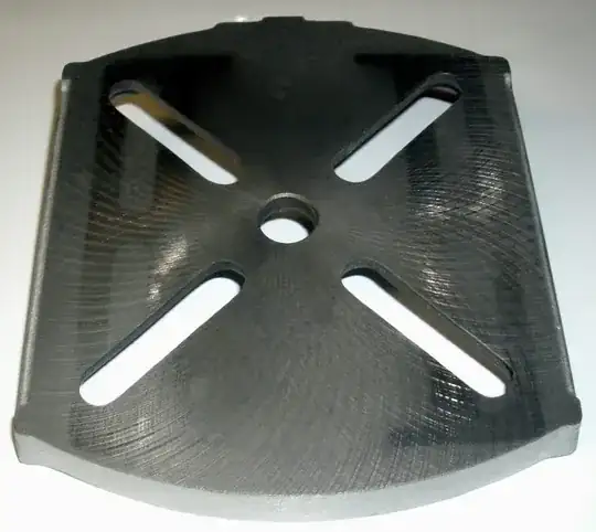

I used it on a drill press my buddy left out on a patio in the rain for a year. Virtually no scrubbing. I don't understand how this is not one of the most widely known products in the world. It is THAT good. I guess with the military as a client, they don't need the business from the public. Here are some pics. Truly an amazing product. I purchased a gallon of it at a Harbor Freight store for $20.
Before:
After:
