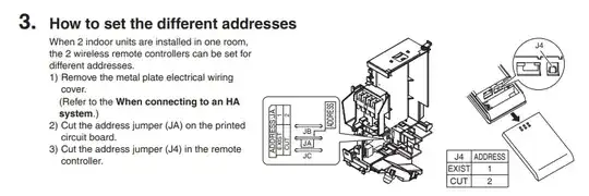

Change the address on one of the units.
This manual (page 5) is for the L series units, but by memory the remotes and controls are the same/very similar.
Page 5 of daikin manual
Cut the jumper J4 in the battery compartment of the remote, and jumper JA in the electrical compartment of the indoor unit.
Be aware that the electrical compartment has live wires inside. Cut power to the unit before opening it.
Only do this on one unit, or you'll have the same issue again.
