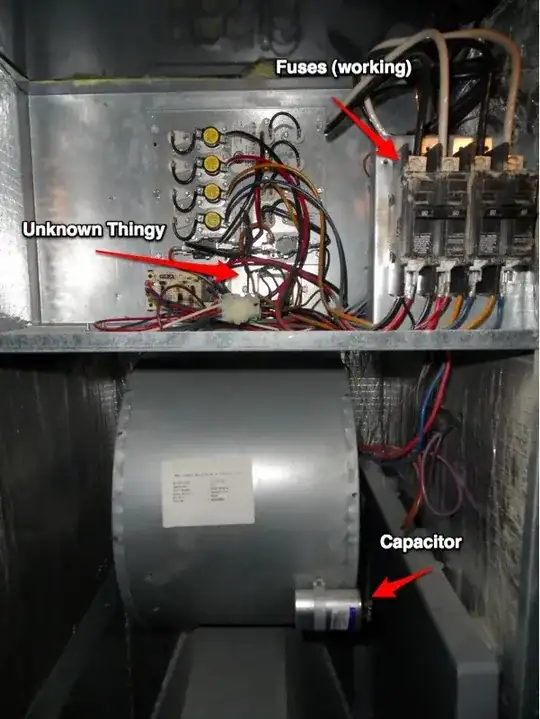

Took some pictures for my own sake and for explanations sake:
First, here is the whole picture:
alt text
Here is the capacitor (the only one I can find anywhere):
alt text
When I shorted the capacitor and then tested it for voltage I get nothing at all. I have no idea if that's normal but I only have a Voltage meter not a Multimeter.

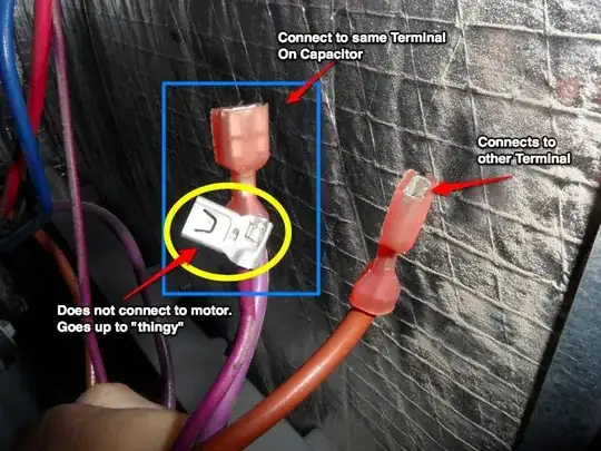

Here are the wires that went into the Capacitor:

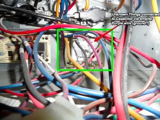

alt text The 2 purple ones went to the same terminal (top) and the orange went to the other one. The thick purple and the orange ones then went to the back of the blower motor, while the small purple one traveled up to this thingy:
alt text
I have no idea what it is or what it does.
So where do I go from here? There are so many wires that I can't make sense of them all and I have no idea what the "thingy" is or if it's the problem. Any help is much appreciated.

    The "thingy" appears to be a transformer. – James Van Huis Jan 06 '11 at 22:17

  • I did resolve it, the blower motor was fried. I found another motor at a relative cheap price but did find out that my furnace was installed with a stupidly rare blower that no longer has a motor in production. I got the last one available in the U.S...so if it fails I need to get a new furnace installed. – James P. Wright Feb 16 '11 at 20:10
    A key thing I didn't know at the time. The blower should spin freely if the motor works. If the motor is blown, and you spin the blower blades and they don't keep going for a while then your motor is bad. I didn't realize that or I could have solved the issue quite a bit faster. Still, thanks to everyone that tried helping! – James P. Wright Feb 16 '11 at 20:11
This may be as simple as the "start" or "run" capacitor going south (because the motor starts but dies afterwards, I suspect that the run capacitor is blown).
If you are comfortable digging around in the control box for the furnace, then you should be able to find 1 or 2 large-ish capacitors. If you have a multimeter, you can test them against the specs that are listed on the casing. They should be within 10% of the nominal value. If you don't have a meter, then you can still give them a physical inspection. Occasionally, they will bulge or leak or give some other indication that they have failed.
If you find that either of them has failed, then you should be able to find a capacitor with similar specs online (or at a local HVAC supply). It should not run you more than about $15.
