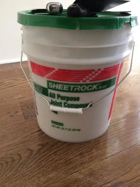

I can't find answer anywhere, can somebody tell me why and how to avoid these little dots/holes when I spackle.
I also including the pic of the compound I'm using.

    Those are due to air bubbles in the joint compound. If you happen to have a vibrating product settler, you could just place the bucket on it for a few hours. – Dan D. Jan 28 '14 at 19:56
    I would add to the good answers that: if you're *spackling*, use *spackle*. If you're joining wallboard, use wallboard joint compound. They're not the same thing. Spackle doesn't shrink when it dries but is hard to feather around the edges of a large hole. Joint compound does shrink and is intended to be applied over large areas in multiple coats. – Eric Lippert Jan 28 '14 at 23:12
    And your initial job looks reasonable. Let it dry thoroughly; maybe aim a fan at it if you want to speed it along. Sand it down and do a second and then third coat, sanding between. Stir the compound thoroughly before you put it on; that will help. – Eric Lippert Jan 28 '14 at 23:14
