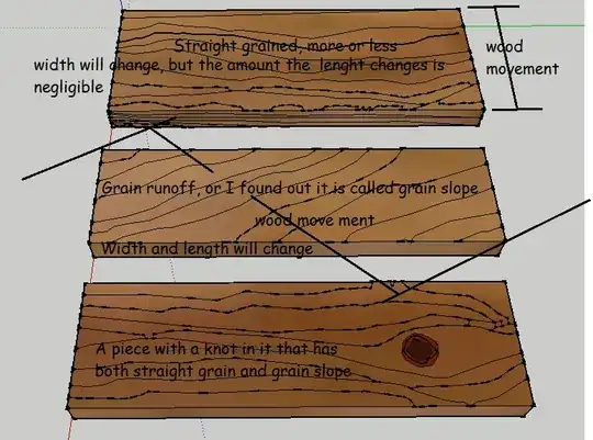

I am surprised this even happened at all. That is given 2 things have been met. The moisture content of the trim that you were using was low enough, 6-10%, and the wood used was a decent grade that did not contain "grain runoff".
The way to minimize the gaps that occur is to use biscuits in the joints.
The style of trim you chose, the traditional style that has been done for decades, if not centuries. The reason why it has worked all those years is that all the inside corners that are created by the various layers that make the detail. This hides the little wood movement that does happen. I would think since the trim used back in the day was not kiln dried, and carpenters had to find a way top hide the gaps or cracks created by seasonal movement.
If you did not caulk anywhere on your work, a clean line placed at the inside corners may be all you need, among starting with the things I mentioned at first.
Edit 2-14-2014
It is better you did not sand it anymore. The density of the knots compared to the rest of the wood, would have had the sander grind down the softer wood and left the knots more pronounced. Even with hand sanding, though not as bad. When the wood shrinks during the first year after install, which always happens, well at least most of the time, the knots also show themselves more. If you decide to leave the heads in, BEFORE you caulk, skim the whole face of the offending board like spackling a wall, then sand the whole face with a semi ridged sanding block and 80G sandpaper until you seen the knots just start to pop through, then stop with that grit then go to 120G and remove those 80 G scratches. Prime it and check your work, if it is good then caulk as recommended before. If it isn't, touch up with more lightweight wood filler and spot prime, then caulk.
Here is a sketch that will explain grain runoff to a degree. I found it is also called grain slope. That may have been the proper term all along. Where the grain slope would create a gap like that is in the long trim, the casing on the sides. Grain slope would actually make the piece shrink in length.

  • For trim I used knotty pine from my local home improvement store. I was inexperienced in that I did not anticipate the knots bleeding through. A coat of sealant fixed that just fine. Now it looks like I overlooked something else: moisture content and grain runoff. I have questions about both. How can I find out moisture content. Can you explain "grain runoff"? – user443854 Feb 14 '14 at 14:11
  • Not enough room in the comment box, so I edited the answer – Jack Feb 15 '14 at 01:41
  • Follow up on the moisture content. For the detail of trim you chose, moisture content is not that critical as long as the trim has not gotten wet, if so then it become a problem. I say this because, all wood bought from lumber stores has been kiln dried. When it comes out of the kiln it should be somewhere around 6% moisture content (MC). Sometimes less. After that the MC will increase in storage if there no humidity control, whether it be heat or AC. At the most it will increase to 10% unless it gets wet, then you are in trouble. Beyond that it will take a meter to test MC. – Jack Feb 15 '14 at 15:44
