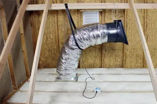

In the ~7 years since this was asked, an obvious-but-new concept emerged that has made whole-house-fans even quieter. The ECM motors from greenhead's answer are getting more common, but now companies are offering mounts that suspend the actual motor and fan a bit away from the intake like shown:
This not only moves the fan several feet away from the intake below, but also reduces much of the vibration to near zero because it's suspended.
So yes, new fans have gotten much more efficient and much quieter.
