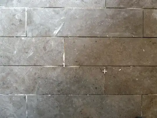

We are currently redoing our master bathroom and our contractor just got half way through laying the tile on the floor. The grout was supposed to be 1/8" wide, but there are quite a few places (mid-field) where the gaps between the tiles are much wider or smaller. The tile we chose is a dark gray limestone-look porcelain and we want to combine it with light (platinum) grout, so the grout will stand out quite a bit relative to the tile.
Clearly, it's not going to be possible for anyone to get all tile gaps to be exactly 1/8". What would be an accuracy (minimum to maximum gap size, for example, or standard deviation), that I should be able to expect from a professional contractor? 10% off from 1/8"? 25% off? 50% off (i.e. 1/16 to 3/16, or: the widest gap is 3 times as wide as the smallest gap)? More?
Here's an example of what the floor looks like:

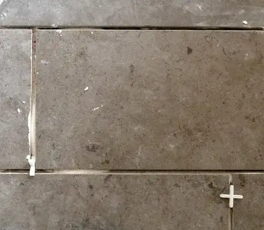

It's a bit hard to tell since the grout isn't in yet and the floor is dusty, but for reference, I placed two of the alignment spacers into the picture: In one case, it easily fits sideways into the grout and in the other case, it barely fits the correct way. So, one grout-line will be almost twice as wide as it's "direct" neighbor:

  • real Stone tiles are not always same size. So you will have variation in grout lines. Ceramic/porcelain should be all the same. I always use spacers with ceramic so i do always get same grout line. I would say more than 1/16" difference would be something to complain about. – Justin K Feb 27 '14 at 23:41
  • If your not happy I would have him remove the worst ones and if they break you will pay for extra tiles. – Justin K Feb 27 '14 at 23:45
  • @JustinK It's porcelain. It just looks like real stone. And the tile is pretty much perfect (at least to the eye). – Markus A. Feb 27 '14 at 23:45
  • I was expecting to see worse. If the tiles are perpendicular to you when you walk in bathroom like the picture I dont think it will be noticable unless you are looking for it. – Justin K Feb 28 '14 at 00:19
  • @JustinK I added another close-up. You don't think a factor of almost 2 in width-difference will be noticeable even if we use very light-gray grout (kind-of the same color as the thinset you can see in the left gap)? – Markus A. Feb 28 '14 at 00:49
  • I don't think you're going to get much better from a tile setter you hire for one off jobs, unless you luck out and get a craftsman-type. This is why I do almost everything myself. We've seen a lot worse than what's pictured from "professionals". – Edwin Feb 28 '14 at 05:05
  • @Edwin I'm beginning to think the same... And given how things have been going with this construction, I don't think it would take any less of my time to just do it by myself either... This is our first construction project that we hired someone else to do for us and it's definitely been quite the learning experience... (The tile job isn't even really a problem, I just wanted to calibrate my expectations... Other things, like randomly cutting load-bearing beams, have cost me much more sleep.) – Markus A. Feb 28 '14 at 05:12
  • I don't see a problem with this level of accuracy. – Bryce Feb 28 '14 at 20:18
  • Got good news: The contractor agreed that this needed to be fixed. I didn't have to argue it at all and he even pointed out a couple more spots that I hadn't noticed yet. I guess I wasn't being too picky after all. :) "Yay!" for pride of workmanship! :) – Markus A. Feb 28 '14 at 21:47
  • Contrasting grout will accentuate any variation in grout line widths. "Rectified" tiles have the edges machined for precise tile dimensions, where often normal tiles will have noticeable grout line width variation regardless of the tile setter's abilities. The conventional wisdom for hiding such variation is to increase grout line width. – popham Sep 26 '23 at 19:54
  • The TCNA has a manual. It has workmanship standards and design details that architects frequently snatch without revision. If you don't know much about tile, then agreeing to the workmanship standards of that manual with your contractor can save everybody some grief. I'm pretty sure that the TCNA grout line width precision is predicated on the grout matching the tile somewhat, however, where your contrasting grout might not look good even for work in compliance with the TCNA manual's standards. – popham Sep 26 '23 at 19:59

There may or may not be an easy answer to your question. I would start by calling the grout and tile manufacturers to get their opinion. In general though... You should reasonably expect to get the quality of service you contracted and paid for.
Bottom line is do you think you're getting what you paid for. Not what you think you paid for. If you hire the best electrician in your area to paint your kitchen, don't expect to have the best painted kitchen in town. If you don't hire someone who specializes in tile installations, don't expect to have the best tile work either. If you hire the best tile setter you should expect to have an amazing tile job. You should always check references and try to see examples of their work from the people that you found them through so you have an expectation on the general quality of their work.
Looks like a 3x9" tile (or somewhere around there) which results in a lot of grout lines. On top of that you want thin grout lines. It all adds up to a difficult tile installation. At what point was the contractor aware of the tile you were using? Was it when you spec'd the job or the day he showed up to lay the tile? Usually there's a little bit of blame on both sides.
I'm just a DIY'er but I would have used more tile spacers than he appears to have used (based on the marks in the mortar not the spacers in the photo) and would have scooped out any excess mortar in the joints and off the faces of the tile before everything dried. There may however be other issues that affected the spacing that were outside his control or the budget for the project.
Things may look different (better or worse) once the grout is in. Maybe you want to put grout in a small section before the rest of the tile is laid to get a better idea. If you're not happy talk to your contractor to see what can be done. Depending on the situation it's probably fair that both parties eat some of the cost to redo (or not.) Or just get a different contractor.

  • Good point about hiring a specialized tile setter... He's a general contractor and is having his "foot soldiers" do these kind of things. For that, maybe I did get a good result... I was just hoping that there are some workmanship standards that everyone should be able to pass, preferably measured with numbers (standard deviation of grout width no more than x% of target). The tile is 6x24 and the grout lines are 1/8". Didn't look like it should be that difficult... It just doesn't feel good if you look at something and go: "Man, I could have done this nicer, faster, and much cheaper myself..." – Markus A. Feb 28 '14 at 16:40
  • @MarkusA. Updated my answer with some more information I found relating to ANSI standards for tile grout line variations from The Tile Council of North America. Again if you don't feel you're happy contact the GC before any more tile gets put down. – OrganicLawnDIY Feb 28 '14 at 19:37
  • "For example, while a difference of a 1/16" of an inch may seem small on a 12" tile, this is readily apparent compared to a 1/8" grout joint." In the document you linked they even say "This would be immediately noticeable and unattractive." Perfect! That's the kind of strong statement I was looking for. Thank you! Great reference! Given that our tile is pretty much perfect, I think 50% variation is a lax-enough upper limit for what I would think is acceptable and should be re-done. Let's see if I can get our contractor to agree... It'll only affect 5 or 10 tiles or so... – Markus A. Feb 28 '14 at 20:09
  • @Markus, is this the Marazzi Montagna tile from Home Depot? – OrganicLawnDIY Feb 28 '14 at 21:18
  • Actually, this tile was a rare find. We were trying to match dark grey limestone as closely as possible without the maintenance needs. It's the Eternal Limestone series from Arizona Tile in the color Anthracite (http://www.arizonatile.com/ETERNAL-LIMESTONES-SERIES-P909.aspx - it's much less brown in real life than in their picture). The size (6x24) is available as a special order. No other limestone-look tile that we found even came close to this one. And they are nice and thick (almost 3/16") and commercial-rated, so I'm hoping (if we can get them laid right) that they will last a life-time. – Markus A. Feb 28 '14 at 21:43
  • @MarkusA. Main thing I wanted to see is if the tile was rectified or not. Rectified means they take an extra step to make sure the edges are straight and little variation in size. You pay like 3x more for rectified tile but you do it so you can get the thing grout line you wanted without the problems you're having. It also makes it easier for the installer to get straight lines vs non rectified tile that can have more variation, even if it's manmade. I'll update my answer later I'm a bit busy now. Just wanted you to know. – OrganicLawnDIY Mar 01 '14 at 01:38
  • "...do you think you're getting what you paid for. Not what you think you paid for." Huh? – Tyler Durden Jan 14 '15 at 21:44
If you're not happy with the job or you have concerns, you should talk to the contractor. Make sure it's very clear what quality level you expect, and that you're concerned that this does not meet that expectation.
You may find that there was a reason the tile was installed in this way, and that the experienced tiler knows you'll never notice the flaws in the finished product.
If you're inches from the floor with a micrometer in hand, you'll notice every imperfection. However, if you're 6' from the floor, your eyes might say it's good enough. Most times in building, it's not about being perfect, it's about looking perfect. Once the floor is done and the grout is in, you might never notice the differences. Though the opposite may also be true, and the grout may make the differences stand out badly.
The fact is, you've hired the contractor to complete a job. If you're not happy with the work, you should discuss it with the contractor. If they are unwilling to meet your expectations, you may want to consider finding a new contractor.
    +1 on noticing things more in different situations. Know someone that had a contractor redo a kitchen and it looked great but there was one small flaw of trim not lining up perfectly that I didn't even notice until it was pointed out. – OrganicLawnDIY Feb 28 '14 at 15:42
    I totally agree. My best friend has had clients who would ask him to redo work that deviated by a 64th of an inch, because that kind of perfection was important to them... so he did (it was interior finishing work, and they paid him well, so it was difficult but not unreasonable). I also helped him on some jobs where "good enough" was good enough, and so he did it that way. A contractor should be able to do the job to whatever degree of perfection you're willing to pay for ;-) If he can't, you should find someone who can. – mHurley Feb 28 '14 at 15:50
Having done a few tile jobs for myself, my rule of thumb is 25%. That is 1/8" grout lines should vary no more than 1/32. I'm somewhat more stringent on continuations. e.g. I don't like a line that goes from 5/32 to 3/32 in a jump. For this reason I prefer running bond patters. One direction I can adjust without it being noticeable.
I find 1/8 a very hard standard. I am the process of using 3/16 spacing with 8/10 wall tiles. For floors I like 1/4.
Before you get in too much of a snit about this, go look at commercial tile jobs. Washrooms are the classic example. See how consistent they are. A lot of them are not very consistent, but few people notice.

Also, FYI I measured your photo and there is approximately a +/- 1% difference in height among those tiles.

    Of course I wasn't going to take the issue to court! That's ridiculous. All I wanted was to get an idea of what would be reasonable to ask of my contractor to gauge whether I should engage in an argument with him about redoing the worst ones or whether that would be inappropriate. Luckily the guy in charge himself agreed that a few of the tiles should be redone, so that issue is resolved now... – Markus A. Jan 15 '15 at 08:17
  • Also, can you tell me what software you used to measure the photo? A 1% difference corresponds to just over 1 pixel in the photo, and given that the tiles are not photographed perfectly straight on and the image is a touch blurry, you'd have to average along a significant portion of the length of each tile to get a measurement with any sort of accuracy. I doubt you did this by hand as that would take a long time. Would be useful to know if such software exists. I'd have a couple of other use-cases for it! – Markus A. Jan 15 '15 at 08:27
  • @MarkusA. Adobe Illustrator has a "measurement" tool that allows you to exactly measure distances in images. The tiles in the image vary between 114 and 116 pixels. – Tyler Durden Jan 15 '15 at 13:25
  • It only measures along a single line across the image, though, doesn't it? And if I zoom into the picture, I have trouble deciding which exact pixel is the end of the tile. Additionally, given the slight perspective and lens distortions of the image and the blurriness, one would probably have to run an edge-detection algorithm over the image first and then average the edge across a wider strip in the image to get accuracies in the single-pixel-range. But, you got me interested, so I will measure the actual tiles when I get back home next week and report back if I don't forget. :) – Markus A. Jan 15 '15 at 14:48
  • @MarkusA. The best way to measure the tiles is to get an absolutely flat surface, like a pane of glass and put two tiles on it next to each other standing on end. Then get a straightedge (ideally a machinists rule) and put its edge on the top of the two tiles. Place a light behind. If there is any different in height then the straightedge will be bevelled up and light will shine through the triangular opening. This method can detect variations as little as a thousandth of an inch. – Tyler Durden Jan 15 '15 at 16:26
I have to put up with a lot of warped and deformed / bowed tiles due to the poor quality so i do not agree with anything regarding gaps and unevenness of tiles no room is square no walls are flat and all tiles cut and crack differently according to the type and glaze Finnish and that is that good planning good prepping correct adhesives keep ceiling down lights away from them they cause the worst shadows across tile gaps
