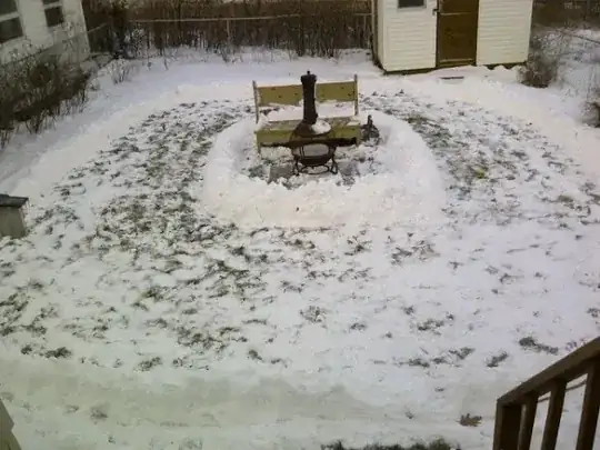

I'm considering building a small temporary ice skating rink in my backyard. I'm hoping to do this without buying many or any materials, and without causing any devastating damage to my lawn when spring rolls around.
Does anyone have any suggestions/experience/techniques for building a good quality skating rink at home?
Some things that might be relevant:
  • The ground is thick grass and fairly lumpy.
  • Temperature is conducive to making ice, we get some days around 0°C (32°F), but most are under -10°C (14°F).
  • Ground is mostly even, although slightly sloped on one side of the yard.
  • Lot next door is lower than mine and vacant, providing a convenient spot to drain to in the spring.
Here is a photo of my yard and the approximate dimensions I'm going for (built with tentative snow walls). I'm going for a skating oval, with a larger piece in front and the fire pit and bench in the middle.
back yard ice rink

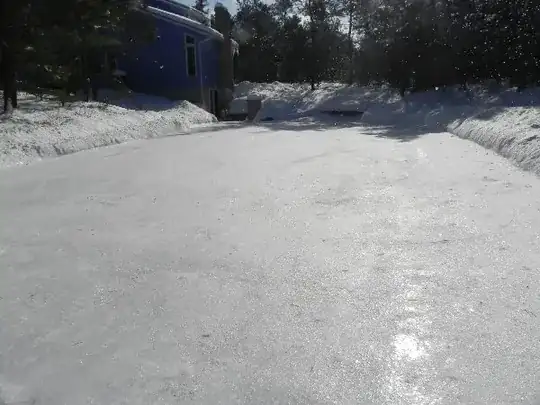

our rink in January
We lift the shovel carefully as we clear snow to make the edges, and we water those too which hardens them enough to mostly keep pucks out. We have over a hundred pucks (gathered by a bored younger brother hanging at the arena during years of skating lessons) so if a few go into the snow we don't worry, we can gather them in the spring. You can also water the hillside if you have older children who can handle it. The non-flatness of the lawn is a feature - beginners can be put at the top of a slight slope to give them a boost, and coming up that slight slope slows you a little before you need to turn.
It's less work than you think, and incredibly rewarding. Ours is at the bottom of a hill so it also adds fun to tobogganing, but the real point is that anyone can skate any time, for 10 or 15 min if that's all they want, or all evening, and you can have skating parties. It doesn't really take any skill or equipment other than the hose and a snow shovel.
