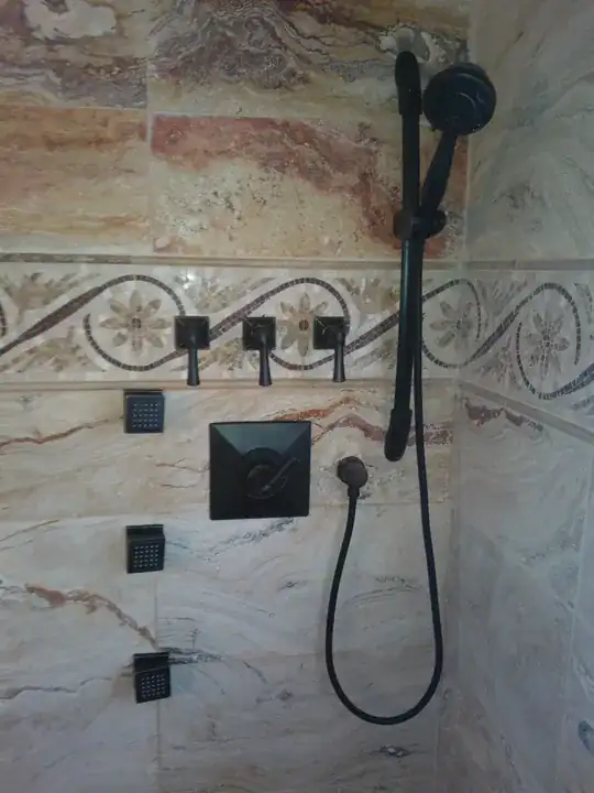

The current best practice is to place waterproofing OVER the backetboard and just UNDER the tile. Thin sheet membranes like Kerdi or NobleFlex are examples . Paint on membranes can also be used, such as RedGuard or AquaDefense.
This a is a recent job I completed illustrating Kerdi over Hardibacker.
Kerdi membrane over Hardibacker
