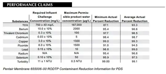

If a filtration system is NSF compliant, it will list the Performance Claims. Performance claims list what is filtered out, and at what level.
Performance Claims
Example performance claims from Krystal Pure™ Reverse Osmosis Systems KR5 - KR10 - KR15 (PDF)
