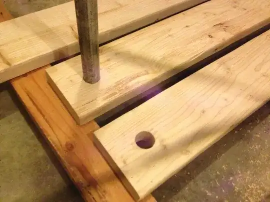

I'm making a stand-alone pullup bar and I bored 1 1/4" holes in 2x6's for my 1" galvanized pipe (1 1'4" outside) to slide through. Only the pipe is definitely 1 5/16" (thank you, guy at Lowes) and I can barely thread the first 1/2" of it with all my strength. I tried wrapping lots of sandpaper around my speedbore bit with a dash of 3M 77 and that slightly worked but the sandpaper wore out way too quickly to ever get me there.
Does anyone know how to uniformly sand the inside of the holes to give me my 1/16" of an inch?? I've only been able to find videos on how to go from one size bit to another, but nothing on how to make the hole you already have slightly larger.

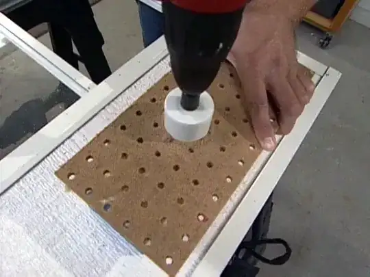

The general method I use to make a bigger hole is to take a scrap piece of plywood (1/4" works great) or pegboard or similar that is a bit bigger than the hole, clamp/screw/hold it in place, then use the correct size hole saw to drill through that and into the board. This gives enough of a start to keep the hole saw in place to drill the rest of the way through.

    Good idea on the plywood on top. The bigger bit is the easiest way to go and really you are worried about the kickback and new hole jumping off-center. – DMoore Mar 25 '14 at 19:27

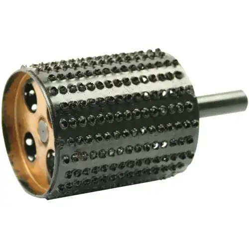

Thank you to everyone for your insight! I made a quick stop at the Lowes down the street and picked up a few inexpensive options you all mentioned. The one that absolutely stood out for my purposes was the drill rasp. As soon as I began I knew it was the one.
I went back over 4 holes, each taking about 1-2 minutes to effectively widen and shape. I was very happy with my level of control.

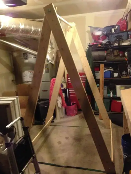

Here's the finished pull-up bar. I had to build it in some tight quarters due to some choice weather. It can be used then collapsed and slid in a tight spot. Again, thank you all for your wonderful help. This new guy got way more feedback than he was expecting! Cheers
This website is awesome.
Tom G.
  • 201
    Very nice, elegant design — in fact, this is exactly the kind of set-up I've been looking to build. Are those just nylon straps at the bottom? – Reinstate Monica -- notmaynard Mar 26 '14 at 18:07
  • They are from an old tiedown I was no longer using. It was just long enough once cut in half. I folded over and and adhered both ends of each strap about 1/2" then adhered to all the bottoms with a couple of finishing screws for added support. Solid as a rock. – Tom G. Mar 26 '14 at 22:50
  • Everything else you can see pretty clearly except that I used: A 1"x5' galvanized pipe, a 1 1/4" pvc pipe on the outside and a washer in between each connection. I can't remember what I cut the pvc to exactly, but it was 5' minus (6" for the wood + 3/8" for the 6 washers + 1/2" on each side for the end caps to be screwed on). Those end caps DO NOT screw on very far, so before you buy them, screw them on yourself, measure how far they go, and use that as your final measurement. Doesn't hurt to get an extra 2 washers in case you need the extra tension. All in all super simple design and sturdy. – Tom G. Mar 26 '14 at 23:00

    Wood rasp drill bits aren't hard to find, and will do the job: https://www.google.com/search?safe=off&client=firefox-a&hs=g4m&rls=org.mozilla%3Aen-US%3Aofficial&channel=sb&q=wood+rasp+drill+bit&oq=wood+rasp+drill+bit&gs_l=serp.3..0.15090.17474.0.18199.5.5.0.0.0.0.173.729.0j5.5.0....0...1c.1.37.serp..0.5.729.p0R292iPPk0 but this sandpaper on a stick thing looks like it might require less finess to keep things round. It helps to draw a circle around the hole at about the final diameter you want. That makes it easy to see when you go asymmetric. – Wayfaring Stranger Mar 25 '14 at 12:50

There also exists a tool like this called a drum rasp. It might help your situation.
