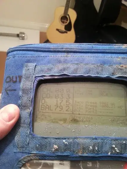

An insepector from the local council has installed a data-logger, whilst he was in the basement he took a reading that I've attached below. When this reading was taken the air felt poor, but by no means the worst it's been, a candle wouldn't stay alight. An breathing during conversation seemed laboured. It looks like the assumption of displacement doesn't look correct, there's more to it. Here's the readings:
Gas - Reading (Normal)
CO2 3.3% (0.04%)
O2 17.5% (20.8%)
Other 79.2% (unchanged?)

  • @gm Quick update, I'll update the question tomorrow, but in the meantime, an inspector arrived today with data-logger, whilst he was here, he did a quick reading, CO2: 3.3% O2: 17.5% Balance 79.2% , I'd say it was an average day, matches would light but a candle would struggle to stay alight. – Dog Ears Apr 23 '14 at 23:27
