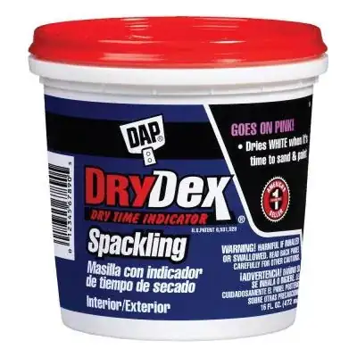

You want spackle. It sticks, it doesn't shrink, and it can be sanded flush. For more detail, see this awesome article that turned me on to the technique: http://www.thejoyofmoldings.com/when-to-use-spackling-and-when-to-use-caulk-moldings/
Spackle is probably one of my favorite compounds; it just has so many uses!

    Quick tip: avoid the pink stuff in wet areas (e.g. bathrooms). If the spackle gets wet, it will go back to pink. This is more of an issue when you have white paint and may miss a spot when touching up. – BMitch Apr 08 '14 at 23:51
  • @BMitch: Depends on what you're covering it with. Since my bathroom had a purplish paint job (previous owner, not my fault), I didn't especially have to worry about a bit of pink showing through. – keshlam Sep 18 '14 at 02:53
