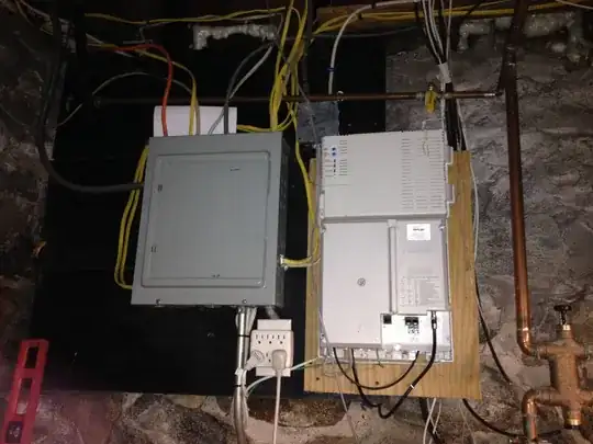

I'm thinking about installing a new circuit. The panel is on the wall in an unfinished basement. Three questions:
  1. Is the new NM cable going down to and around the panel considered to be "subject to physical damage" (300.4) so it must be protected as described in 334.15(B)?
  2. Does the matter whether the cables are above, below, or on the side of the panel, or how high up it is?
  3. If protection is required, should I sleeve them in EMT up to the floor joist cavity? Are there other solutions that are practical?
I'm in Massachusetts, so NEC 2014 applies with these amendments. After much digging, I haven't found anything explicit in the code. But I'd like to know not only what the NEC will let me get away with, but also what is sensible and good workmanship. I wish I could look at what's already there for guidance, but it looks like this … at least I would like the new work to be done properly.
panel
I'm unsure about how to interpret the following from 334.15(C):
Nonmetallic-sheathed cable installed on the wall of an unfinished basement shall be permitted to be installed in a listed conduit or tubing or shall be protected in accordance with 300.4. Conduit or tubing shall be provided with a suitable insulating bushing or adapter at the point the cable enters the raceway.
Does this mean that if you have NM on the wall in an unfinished basement, then it is considered to be subject to physical damage, and you must put it in listed conduit or tubing unless it is already protected as described in 300.4 (none of which seem relevant, especially since the Massachusetts amendments delete 300.4(D))? Or can it still be unprotected if it is somewhere that is not subject to physical damage (however that is decided)?

    In my area it only has to be protected in a finished area. I am going off inspectors (who use NEC 2011... kind of) wants. I am sure there are other interpretations though. – DMoore Apr 09 '14 at 18:45
    So in an unfinished area you're not expected to protect at all? My work won't be inspected, so I don't have an inspector's interpretation to go by. – Vebjorn Ljosa Apr 09 '14 at 18:48
  • NM cable has to be protected on a wall in both finished and unfinished locations. However, I think there's a loophole, since the wiring is fastened to the plywood. I'm not exactly sure of the code section that covers this, but it's fairly common practice. – Tester101 Apr 10 '14 at 17:16
  • I am pretty sure that this depends on the local code but, generally, it is OK to leave exposed Romex in unfinished (exposed framing) areas. On a separate note, you don't get to see very many stone walls in the U.S. these days. It's pretty awesome. What year is the house? – amphibient Apr 10 '14 at 20:27
  • Thanks.The house is from the 1880s. It's nothing special here in Massachusetts. And there is nothing awesome about a fieldstone foundation: it's [messy](http://diy.stackexchange.com/questions/2824/what-kind-of-mortar-should-i-use-to-point-a-fieldstone-foundation) and [leaky](http://diy.stackexchange.com/questions/16000/how-can-i-prevent-water-from-being-fed-to-my-foundation-through-the-gas-line-dit). – Vebjorn Ljosa Apr 10 '14 at 21:23
  • @Tester101 - I would like to hear more about that. I do a lot of basements and it is common to not drywall a storage room. We leave wiring exposed running through the walls - other side being drywalled for finished room. 1 out of 5/6 inspectors will make us throw up some sheet rock. They often have no code to reference other than saying, this is what we want. Not a huge deal because a big room is $100 and an hour of screwing... Never have I had any issues near the panel or anything running in the ceiling of unfinished room. Attics are unfinished rooms right? (not sure) – DMoore Apr 11 '14 at 22:15
It's definitely a interpretation issue with the local inspectors. You can improve the installation in the picture by following the guidelines in 110.26 they may allow the wire within the working space about the panel to be not subject to damage but the water line should be rerouted to be outside the working space described in 110.26 also the wire should be supported per 334.30.
user24125
  • 225
What I would do, and I’m not kidding, I would find a large, nearby housing development, where they are currently building homes and pretend I’m interested in buying and have look at some samples. Hopefully the electrical services are in the basements and they’re unfinished. Study how the wires are installed for everything down there sump pump receptacles, HVAC equipment, everything and then you’ll know. What you’ll most likely be looking at is a no frills installation, just enough to be approved, no less and no more.
