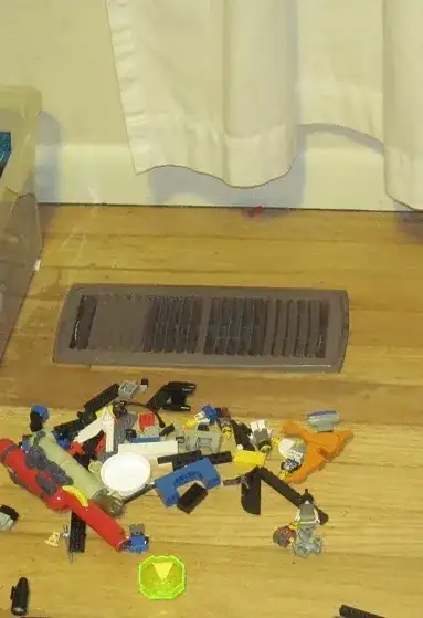

My kids like to play with Lego bricks on the floor, and sometimes a small piece will fall in to a heating register. Sometimes I can pull them out, but usually they fall too far, and there are sharp edges that like to draw blood.
Is there something I can do to block bricks from falling in, without interfering with air flow?
lego bricks peering in to the abyss
