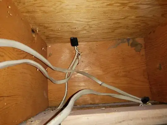

I'm doing some remodeling in my basement and part of that work involves moving a switch. When I was tracing the wires for the switch I found this above my dropped ceiling:
Bad Wiring
Now, I'm no electrician, but this does not look up to code to me. Further investigation revealed this in another area of the ceiling:

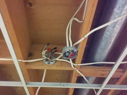

Junction Boxes
I'm unsure if these junction boxes are installed to code, the one with all the wires hanging out of it looked particularly suspicious to me.
Now, for the first picture, my idea was to install a junction box in between the joists just to the right of the picture (hot wire is coming in in under the joist to the right, the switch & an outlet are toward the camera, and the load the switch controls is off to the left). I'll probably end up re-running a couple runs of wire, but that's not a problem as everything is accessible right now.
My primary question is, does NEC allow for junction boxes installed above a dropped ceiling?
Are the boxes in the second image installed correctly, and if not what is the correct way to install a junction box in this space?

In the first image, the wires being spliced together like that violates NEC 300.15.
300.15 Boxes, Conduit Bodies, or Fittings Where Required. ... Where the wiring method is conduit, tubing, Type AC cable, Type MC cable, Type MI cable, nonmetallic-sheathed cable, or other cables, a box or conduit body shall be installed at each conductor splice point, outlet point, switch point, junction point, termination point, or pull point...
I've also noted some violations in the second image.
Click for larger view
  • Where you have the "no clamps, openings not closed", those holes have built-in clamps. They are supposed to look like that. They're fine. The rest of it looks like crap. – Speedy Petey Apr 16 '14 at 11:36
    @SpeedyPetey You're right, should have zoomed in closer. In either case, the other box does not have clamps. – Tester101 Apr 16 '14 at 11:41
  • My reading of the text suggests that the size limit is for boxes which are *supported* by the ceiling. Boxes which are supported by beams *above* the ceiling would not have that limit, but would probably be required to be within a reachable distance of the ceiling. – supercat Jan 20 '16 at 00:12
    This annotated picture is great! I am printing it as my reminder when working on my basement ceiling. – charles ross Jan 09 '18 at 17:40
You are on the right track. Junction boxes, with blank covers are allowed above a suspended ceiling as it is not considered a closed space. The wires that are loose and wirenuted need to be put in a j-box. Also, clamps need to be used at each wire going into a j-box. Some boxes have clamps pre-installed, if not, you need to use a RX connector in the knockout. Hard to tell from your pics if they are installed. Also, an open hole in the j-box with no wire is not acceptable. Solid metal covers need to be installed on the boxes.

I think even with junction boxes image is still illegal as there should be an insolated bearrier between the 2 junction boxes
