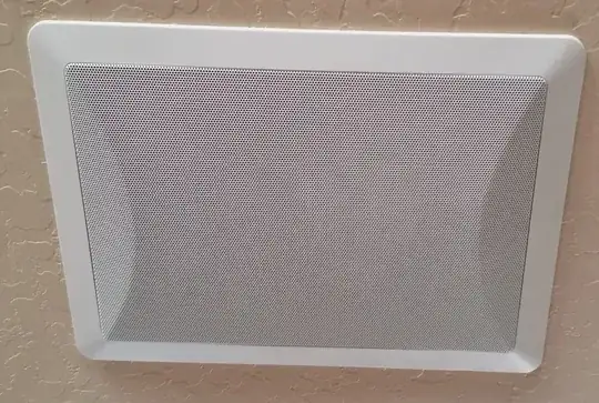

I have speakers in my ceiling and I need to get the covers off to check the settings. I've tried pulling them with my fingernails and a plastic knife but no luck so far. Any ideas?

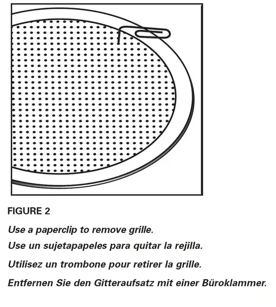

These look like Polk Audio speakers to me - I have the same ones.
From page 12 of the user manual, they suggest a paperclip. I realize yours are square, there are few different models.
If the speaker is already in the wall, carefully hook the grille with a bent paper clip and pull it gently away from the frame

Paperclip kept.deforming. Did it near the edge and got it to pop the edge up. Had to hold the clip near the base of it entering the grill to help support the clip.

I have seen the magnetic type, they are out there. Most of the ones I seen are held in by pressure fit.
To remove the ones you have you will need an item small enough to fit inside the holes with a tight bend in it to serve as a hook to start to pull at the corners. A dental tool has hard enough steel in it to pull with out straightening out. You need to ease a corner out just a little then pull out a little farther down the edge till you get to the other corner. Work all the way around like this a little at a time. Say about 1/8" out. If you pull it out too much at one time you will deform the grill and it will be really difficult to reinstall. By the time you go around the second time it will come free.
