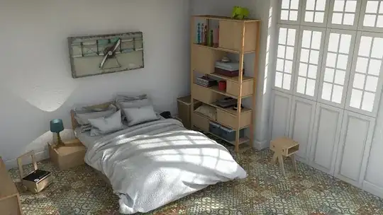

Try Blophome. I've been using it for years. It's very simple and you can add lights and regulate the ambient light of the project. It has a large amount of furniture.enter image description here
