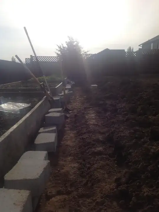

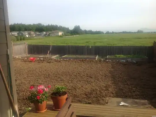

Edit 2: Mark's post taught me you can add photos, so here are some:
From the house
Along the wall high to low
Along the wall low to high

  • Added some pictures to my original post – Jakerc May 14 '14 at 15:09

  • Thanks for the reply! In answer to what it is retaining, we've got a front to back yard elevation change also. We've got some raised bed planter boxes sitting on the lower elevation. The yard used to slope towards the front of the boxes but we've dug about 18" horizontally out of that slope and now have two distinct levels. The wall would split those levels and hold the upper, lawn part of the yard. – Jakerc May 14 '14 at 14:43
  • Added some pictures to hopefully illustrate the wall's purpose. – Jakerc May 14 '14 at 15:10
