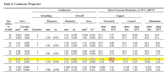

To calculate the maximum length of the circuit, you'll first have to know how much resistance the conductor being used has. Table 8 from Chapter 9 of the NEC, makes this simple. If you're using 12 AWG solid uncoated copper, you'll find that it has a resistance of 1.93 ohms per thousand feet.
Table 8
For the following formula, you'll need to know the resistance per foot. This is easily calculated, by dividing the value above by 1000.
1.93 ohms per 1000 feet / 1000 = 0.00193 ohms per foot
