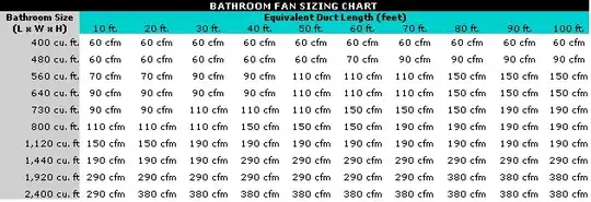

This will completely depend on the number of elbows, the size of the room being ventilated, and the power of the fan.

Determine the proper sized fan
Once you've got all the information, it's time to select an appropriately sized fan. To do this, you can use a chart like this
Bathroom Fan Sizing Chart
Using this chart, you'll find that for a 640 cu. ft. bathroom and 70 ft. of duct (equivalent length), you'll need a 110 cfm fan to achive the recommended 8 air changes per hour.
