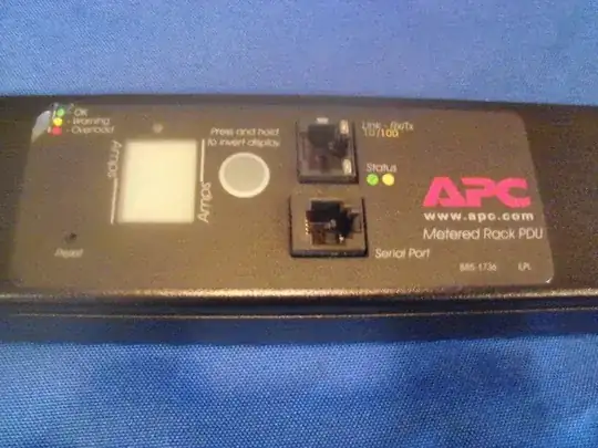

You might be able to pick up a metered rack pdu off ebay. Normally these are quite expensive but a second hand one may do the job. These often come with web interfaces and provide detailed power consumption per port.
You'll need to obtain one that will work with standard electrical outlets though as some of them are 3 phase.
e.g. something like: http://www.ebay.com/itm/APC-AP7830-Metered-Rack-PDU-20A-120V-24x-NEMA-5-20R-/281141812282?pt=US_Power_Distribution_Units&hash=item41755b9c3a
