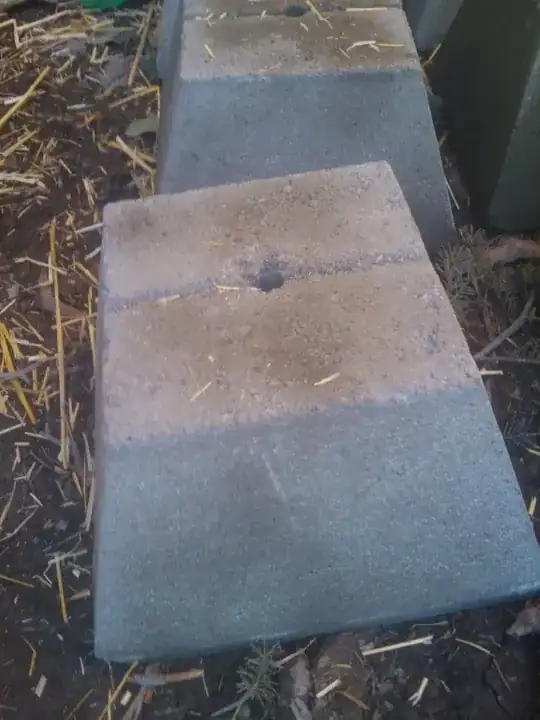

I picked up one of those cheap canvas garages from Costco, to keep a few things out of the weather. It's 10' wide, 20' long, and maybe 11' high at the peak.
Our area is a bit prone to windstorms. I'm in the woods, so it's largely protected from the wind, but I still want to make sure it stays put.
It comes with tent stakes, but the ground is too soft for that to be reliable.
I thought about trying to attach it to concrete pier blocks, since they are heavy, cheap, and aren't permanent if we want to move the garage later. I'd put one under each leg, and fasten the leg to the block.
pier block
The blocks are formed with a hole in the top, about 5/8" diameter. The garage comes with some concrete anchors, presumably for use if you put it on a concrete driveway - you'd drill holes and secure it there. The anchors are way too small for these holes, though. Even the biggest anchors at the local hardware store seem too small.
I could try to buy larger anchors online.
I could epoxy in some inverted screws.
I could try to find some old railroad ties and screw in to those, instead. I'm not sure where to find those around here, however.
I could pour small concrete footings, although then I'm locked in to an exact setup.
What should I do?

You can get concrete wedge anchors in a 5/8" diameter:
To use these anchors, first drive them into the hole (they should be relatively snug to begin with). Then as you tighten the nut around the object you want to secure, the wedge at the bottom expands and holds the bold in place within the concrete.
You can get a 5/8" one at home depot for around $4.
You'll want to make sure the anchor can set securely in the concrete piers you've got, so consider bringing one with you and testing in the parking lot before buying a few more.

  • I have some that look exactly like this, and claim to be for a 5/8" drill, but are still way to small. That was the largest size my hardware store stocked. *sigh* – Jay Bazuzi Feb 05 '11 at 17:00

How about putting in a concrete J-bolt into the 5/8" hole, and then filling the rest of the hole with cement?

Fill in the hole in the pier block with concrete, Let it cure, then redrill to the size you need.
    Hi and welcome to DIY Stack Exchange site. Can you expand on this answer a bit more to explain *why* it might work. – ChrisF Dec 08 '11 at 08:56
Why don't you just drill a new hole an inch or two away from the existing hole? No need to fill the old hole.
