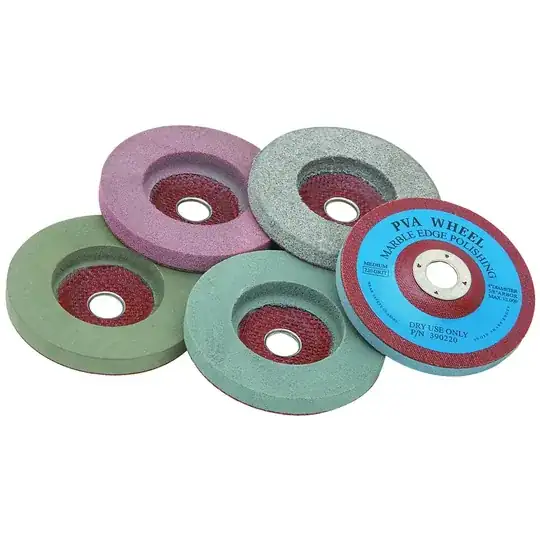

To smooth and polish the edges, I used polishing/"surface conditioning disks" designed for stone and masonry, in the angle grinder. They come in a set of various grains from coarse to fine. Just like sanding, start with the coarse and work your way up to the fine.
stone polishing disks
All of the above parts were done dry; no water involved.
