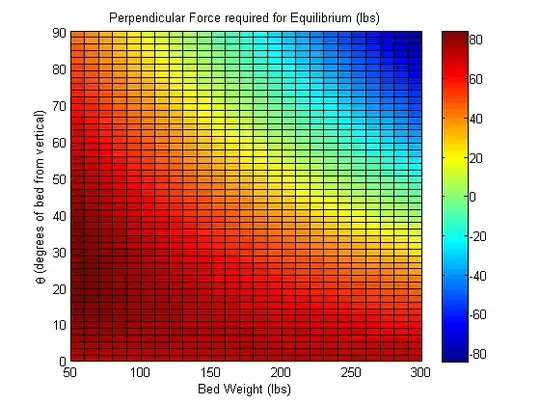

Here's the force profile for various angles and bed weights. The point where it dips negative is when the force exerted by the gas springs is not enough for the bed to be lifted, and you'll need to assist it that much to stow it upright. (All you other engineers out there on DIY.SE, feel free to make sure I didn't make any stupid mistakes. The angle graph looks right to me, but then again, there's some pretty tedious trig to get that monster formula.)
The weights listed in the graph are for actual bed weights - if you took the whole assembly off the wall and threw it on a freight scale, not the force you experienced while lifting up one side of it. The forces (colors) are the perpendicular forces required to pull the bedframe down into a useable position. Where they go negative is the area you'd have to lift the bed up to get it back in the stowed position. enter image description here

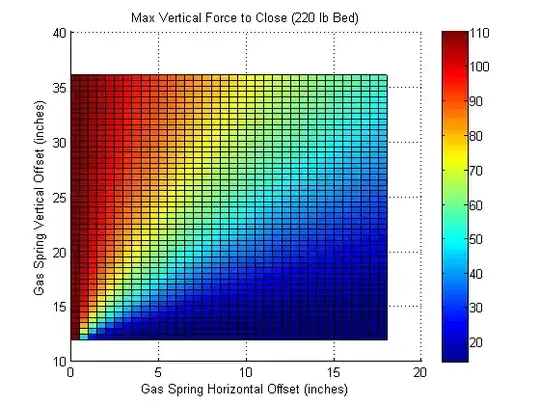

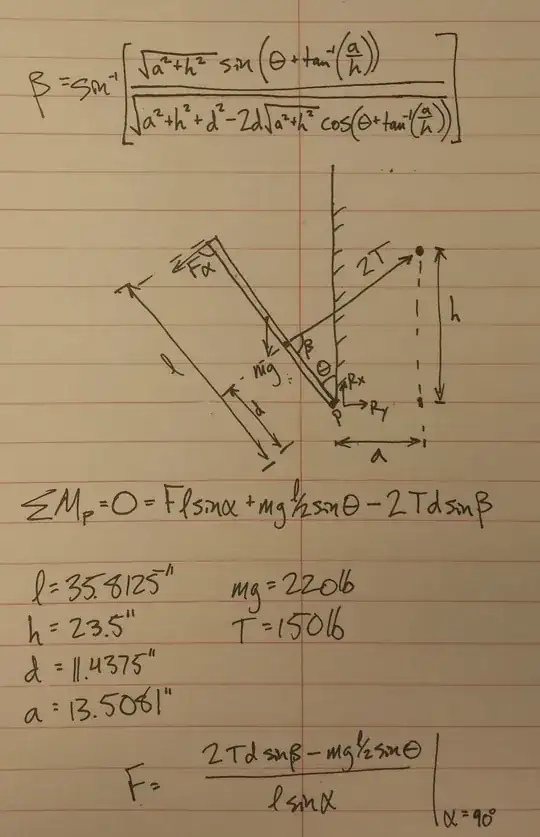

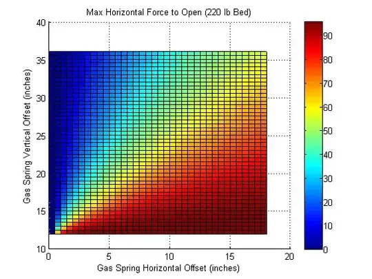

Since you've already bought the gas springs, the best option may be to change the geometry of how they're mounted instead of looking for a different load capacity. Here are some graphs that give the required pull down (rather sideways) force to open the bed and then the lift force required to stow the bed. Note that it's for an assumed 220 lb bed, since I ran out of dimensions to graph things on. Hopefully these plots will allow you to make a decision on what tradeoffs you want to accept if you rearrange the gas springs mounting point on the frame. (You'll also need to check if the gas springs have the range of motion required beforehand too.) The vertical offset and horizontal offset are measured from the bed's pivot point on the frame (distances h and a in the second sketch, respectively).

  • Sorry if this comment shows up twice (I wrote something and don't see it). So, using your graph (very helpful by the way), if the bed weighs 110 lbs at 45 degrees, it seems that about 50 lbs of force will create equilibrium. Am I reading this correctly? – dfife Jun 18 '14 at 18:13

  • @dfife, see the update to my answer for recommendations on what might make your setup work. Also, if you get me the last weight measurement I asked for in my last comment on the question, I can adjust the 220 lb estimate for a more accurate one. – Doresoom Jun 18 '14 at 19:15
