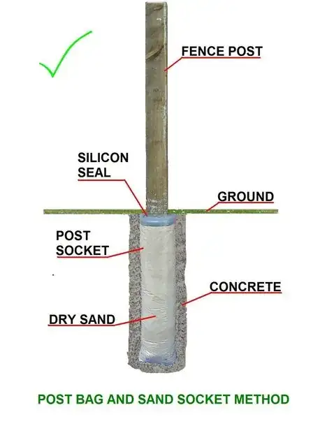

SAND to the rescue.
No concrete needed. Bury an empty 6 or 8 inch tube two feet deep, and flush with the ground. Compact the soil around it. Then center and level your mailbox within the tube, and fill around the post with sand. Tamp the sand down too a bit, then cover lightly with sod.
Next time a drunkard hits it, you can vacuum out the sand and remove the broken post with no tools. Put the new one in and pour the sand back in and your mailbox is back immediately!
Here's a diagram using the same method for a fence post. With the high wind loads of a fence, you might want to surround the tube with concrete. But with a mailbox, it shouldn't be necessary.
Also, with a fence post, sealing the top with silicone will reduce the rate of wood rot. But if your mailbox is getting replaced often, it won't have time to rot.
