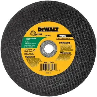

For really hard plastics, I've used a diamond abrasive blade before and that did a great job (these are incredibly expensive if we're talking about a single cut though). I would imagine an abrasive blade for cutting metal would do just as well though:
You should be able to pick up either of these for less than $5.
Wear good safety glasses and do a trial cut first with whatever option you go with - plastic will chip long before it will bind the blade in most cases, and these can be both sharp and high velocity.

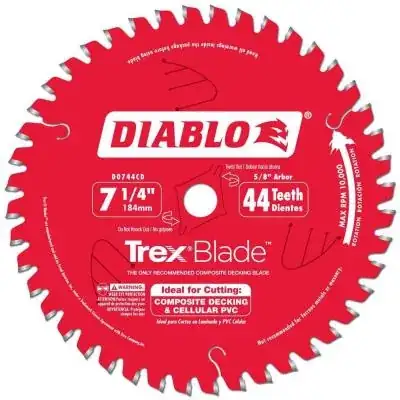

I have a 7 1/4 inch circular blade which is specifically for laminates and plastics. When cutting flooring, I wasn't so impressed with its performance at first but when I tried standard crosscut and ripping blades I was then very impressed. The standard wood working blades got gummed up and melted or fractured the laminate while lugging and jamming the saw motor.
Looking online now, the only blade I see which looks close is this (at $30): enter image description here
