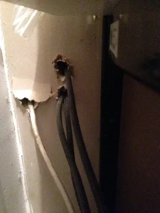

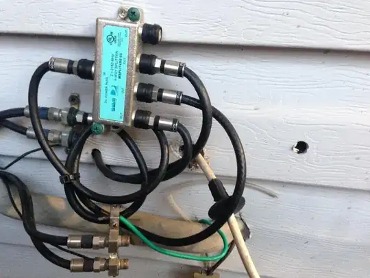

As some of you have surely experienced, residential telecom installers can leave a thing or two to be desired when it comes to how they get the service into our homes.
A small project I've had in mind is to repair the extra holes in my home, and to do a better cable management job with all this coax. What do I need to repair the walls and organize this mess?

  • Organize is a vague term. Be more specific please. Are these holes in publicly visible spaces? – The Evil Greebo Aug 08 '14 at 13:01
    Regarding organization, this is in a closet. I only want to fix it because I like fixing things. – Elliott Aug 08 '14 at 13:23
    This question might be useful [How do I properly feed coax through an outside wall?](http://diy.stackexchange.com/q/42192/33). [This answer](http://diy.stackexchange.com/a/38072/33) is also helpful. They make modular wall plates with a variety of holes, that can accept a variety of ports. You'll need a 4 port plate for the first photo, and a six port plate for the other. Then you'll need modular F type connectors to plug into the plates. – Tester101 Aug 08 '14 at 13:26
    When you're putting ends on CATV cables, I recommend the crimp type ends. Yes they require a special crimp tool, but they are just way better than the twist-on type. – Tester101 Aug 08 '14 at 13:29
  • [This answer](http://diy.stackexchange.com/a/38100/33) might be helpful if you're putting new ends on the cables. – Tester101 Aug 08 '14 at 13:31
  • A [Demarcation Enclosure](https://www.aflglobal.com/Products/Copper-Apparatus/Demarcation/Coax-Demarcation/CableGuard-500-Coax-Demarcation-Enclosure.aspx) can be used to hide the connections outside. – Tester101 Aug 08 '14 at 13:44
