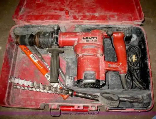

If this is a one-off, rent the cheapest one they have, butcher both the tool, the job, and be done with it. I used to smash through, too, after drilling a bazillion holes before I had a core bit set. Hilti TE72 is one of my best friends, shes discontinued though. Probably because it still works after 10+ years of being utterly dogged-out and only one 'proprietary' trigger replacement from....Bosch. I see these (so pretty) used for ~$800 and 4" SDS core bits for ~$150.
