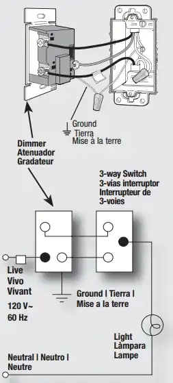

When dealing with 3-way switches, the common is nearly always the odd man out. Meaning the common terminal screw will usually be a different color than the traveler terminal screws. It appears that Lutron devices are wired like this
Lutron wiring
It appears you may have a Lutron (or similar) device, so the wiring for your switch should be like this.
Though since I can't see all the screw terminals, and I don't know the make/model device you have, I can't say for sure.
