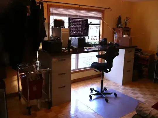

I use 2 3-drawer file cabinets with a 8 foot door. It works really well. Adjustment higher can be done with some 1/4"-1/2" pieces of plywood but the height works well for me. It has the added benefit of storage.

    I like this. Simple and to the point. – Chris Cudmore Mar 01 '11 at 21:14
  • Checked this out, unless there is a place to buy 3 drawer filing cabinets cheap, this setup will cost over $150 – Theron Mar 02 '11 at 14:09
    The 3 drawer cabinets were recycled. Check out a used office furniture supply store. With all of the businesses closing, and no longer using as much paper, there are a lot of these laying around our area for cheap. The door was also recycled. You can find them at salvage places, closing business sales, etc. – Doc Walker Mar 03 '11 at 16:27
  • Any chance you could hit me with the name of that chair? Been looking for something like it for my own standing setup. – Kara Marfia Mar 04 '11 at 13:15
    That is a HAG Capisco chair. http://www.haginc.com/products/hag-capisco/ I got it here: http://www.ergodepot.com/HAG_Capisco_p/8106.htm Love it. You can sit on it or use it for half standing, half sit. – Doc Walker Mar 04 '11 at 20:50
  • Just an update. I finally decided to move to V.2 of my standup desk use. The filing cabinets were great for storage but they were just a little too high for me. I had bought a workbench from Sam's for the pantry that I love. I bought a second and now use it for my desk. http://www.doc-walker.com/Other/SmugShots/i-WzB36BZ/0/M/smugshot8997692-M.jpg It is a bit lower and not as long. It also fits our living room colors better. I am thinking of getting monitor arms to help get them up a little higher. – Doc Walker Jun 28 '11 at 13:41
