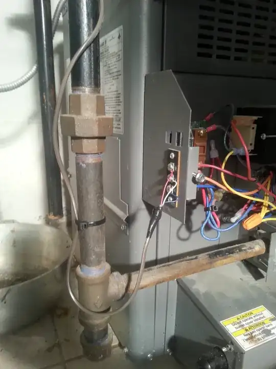

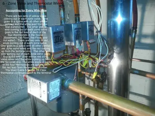

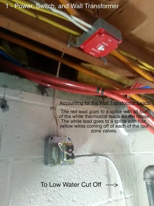

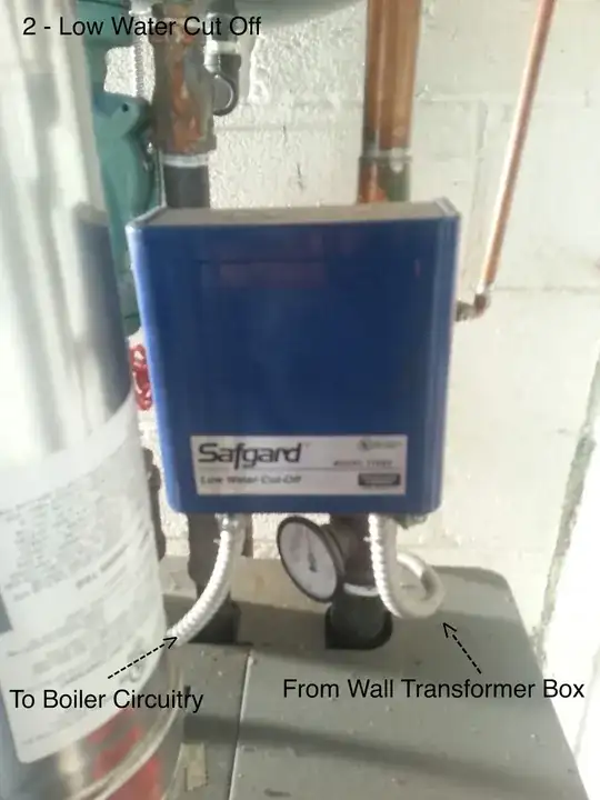

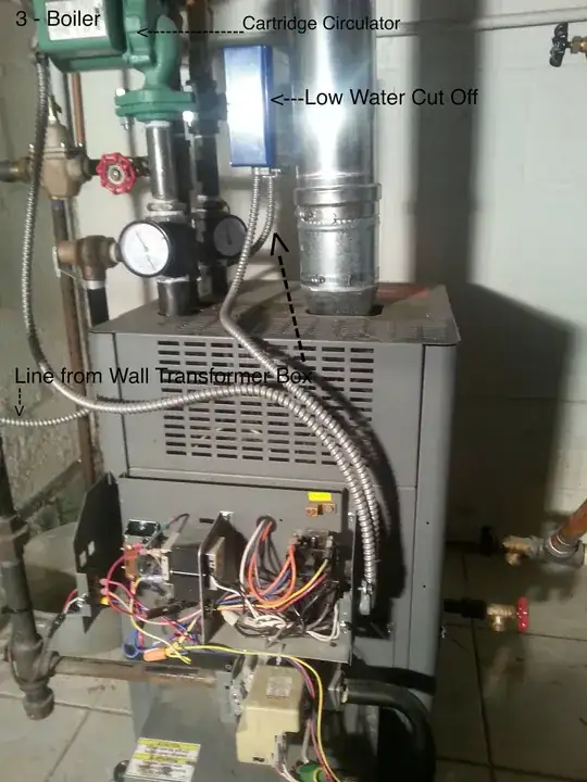

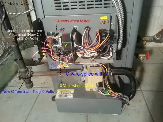

I have a Laars gas boiler that has 3 heating zones. I want to replace the old mercury honeywell tstat on the 1st floor (heat only) with a newer honeywell RTH9580 wifi model. I've taken pictures of my entire system, labeled the wires in the pics to indicate the associated connections, and included the Laars wiring diagram. There is a transformer mounted on the wall near the boiler that is wired in-line to the system (power from the panel --> into the emergency boiler switch --> into the wall transformer --> then to the boiler (low water cut off and boiler circuitry). There is also a transformer within the boiler circuitry itself. Can someone tell me the best method (proper preferred, not necessarily easiest) to connect the C wire? 1 - Power, Switch, and Wall Transformer 2 - Low Water Cut Off 3 - Boiler 4 - Boiler Circuitry 5 - Terminal Strip 6 - Zone Valve  and Thermostat Wiring 7 - 1st Floor thermostat wiring

  • When you say "*24 Volts when tested*" and "*0 Volts when tested*". How are you testing? The **Y** lead is grounded out in the schematic, so you will get 0 Volts from **Y** to ground. You should get 24 Volts between **Y** and **R**. – Tester101 Sep 20 '14 at 20:24
  • Ok the way we wired this up, with the doodad and all…has the wire going to the C terminal coming from the Y, and this leaves the thermostat unpowered. – Evan Sep 20 '14 at 20:36

It's pretty simple actually. When a thermostat calls for heat, the valve for that zone opens, and the boiler is also signaled via the auxiliary switch in the valve.
To get a C wire to one or more of the thermostats, you'll simply run a wire from the other side of the transformer on the wall.
New boiler wiring
NOTE: If this diagram is accurate, the white wire to the thermostat is R, while the red wire is W.
The original wire from the transformer should be connected to the R terminal on the thermostat, while the new C wire should be connected to the C terminal on the new thermostat. This should supply power to the thermostat, and allow it to operate as normal.
The way your thermostat is currently wired, you'll have to swap the white and red wires to get it to work. So white will go to R, and red will go to W.
To make this fit a more common wiring style, I'd probably rewire it a bit. So that the red wires going to the thermostat, connected the transformer and the R terminals. And the white wires connected from the zone valves to the W terminals on the thermostats.

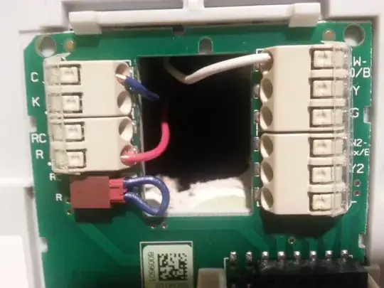

  • no dice. The wiring at the thermostat is normal - red to the R, and white to the W. Should I try swapping them? What about connect the C wire from the thermostat to the red wire coming off the wall transformer? It seems as though the wall transformer wires should be switched, no? – Evan Sep 20 '14 at 22:40
  • What you have drawn out is exactly what I see down at the boiler. How the thermostat was wired I don't recall. I myself ran new wires up to the thermostat, and didn't pay attention to how the old thermostat was wired when I pulled it out (not thinking that anybody would do such a thing). But if the same person wired the original thermostat up that framed the house, then I won't be surprised – Evan Sep 20 '14 at 22:49
  • Yes, I would expect the wires to be reversed at the thermostat. Using my drawing for reference, I would expect the white wires to be attached to the `R` terminal. With an old mercury thermostat, it didn't really matter which wire went where. – Tester101 Sep 20 '14 at 23:01
  • The `R` terminal on the thermostat is power, while `W` is usually heat call. – Tester101 Sep 20 '14 at 23:03
    I'd try swapping them. White to `R`, red to `W`, and your new wire to `C. Do you get 24 Volts between the white wire and the new wire at the thermostat? – Tester101 Sep 20 '14 at 23:05
  • I haven't swapped anything yet. I posted a pic of the wiring at the thermostat to the original posts pics. As it is in the pic, between white/W and the C wire is 24 volts. I checked continuity at the thermostat and the boiler and all checks, so the integrity of the wires is good. – Evan Sep 20 '14 at 23:14
  • Based on what you've said so far, I'd swap the red and white wires at the thermostat. Especially since you said you get 24 Volts between the blue and white wires. – Tester101 Sep 20 '14 at 23:22

    That was it! I switched the R and W wires and it works perfectly. I appreciate all of your help. In this case it looks like poor workmanship on the installer's behalf was the problem. I can't express how grateful I am for your time and effort with this Tester101. – Evan Sep 21 '14 at 20:36
