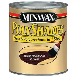

The can says it all. Personally I don't like it but landlords love it. Left with 40% usable material there's not much you can do except replace it all. Multiple rooms worth of salvage may make up for one of them. Reading your other post, this trim was recently reattached, making it rather impossible to remove without destroying it. This product requires only a scuff sanding to bond well, all reasonably done in place.

  • Hmm, I'll give it a try on one of the useless fragmented pieces. If it sucks, I'll just add the can to the collection of barely used paints and finishes I inherited with the house. – Jax Oct 05 '14 at 04:01
  • It's basically a mixture of the two, try making your own. I don't think its going to make anything *lighter* though. Without it being the first coat on fresh wood, it's kinda like just painting on some dark. Useful for quick touch-up on gouges. @Jax – Mazura Oct 05 '14 at 04:52
    The down vote was appropriate, IMO this is a stop gap product. – Mazura Oct 05 '14 at 22:24
