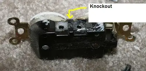

  • Switched outlets - These usually are splits, with one receptacle wired black & white (always on) and the other wired red or blue and white. The red wire is a switched hot, coming from a wall switch. The knockout should be removed, but they may not be on separate circuits. If they are on the same circuit, they will often only have a single white on the neutral side, and the knockout on the neutral side will not be removed.

    What happened to that receptacle? Looks like it was on fire. – Tester101 Mar 07 '11 at 17:34
  • It was the best view of the knockout I could find on google images. – Chris Cudmore Mar 07 '11 at 19:43
