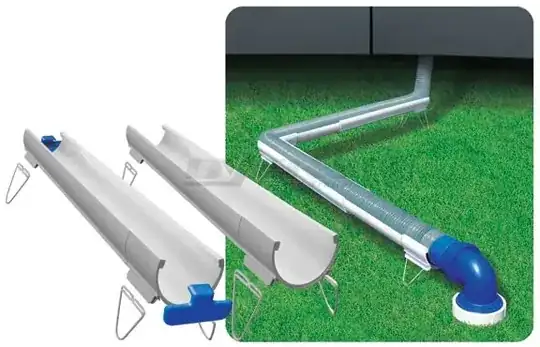

This almost sounds like a common problem with draining RV holding tanks.
You should try to support the drain hose from the tub so you have a gradual slope reaching from the tub/shower drain to the floor.
I have a contraption called a "Slunky" which basically allows my RV holding tank drain hose to be very gradually sloped all along its run to a septic or sewer cleanout.
Here's a picture of a "Slunky" like device
Here's an example of a slightly different approach but same concept

  • Thanks for sharing. At least this gives me the idea that even a gentle slope can help the drainage. – cayblood Mar 19 '11 at 09:49
  • Typically the minimum slope by code for sewer drainage is like 1/4" per foot (the requirement decreases as the size of your drain increases also) so yeah, it only requires a very slight slope. Good luck! – kkeilman Mar 19 '11 at 20:32
