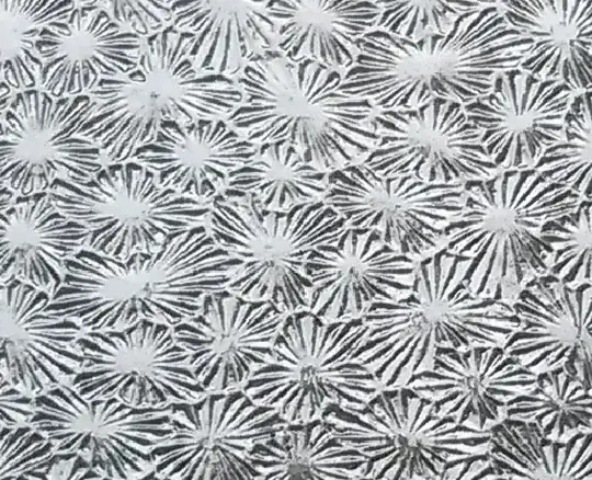

We've accidentally managed to break the glass above our front door, by letting the door slam. I'd like to match the glass replacement, so it matches next door. I have no idea what the pattern is called, and don't know where to look to find a match.
We've had a glass fitter around to quote, who suggested that he had not seen this style and that it is likely not made any longer.
Does anyone know the name of the pattern or could possibly tell me of any good places / sites to look for old glass patterns?
antique frosted glass enter image description here

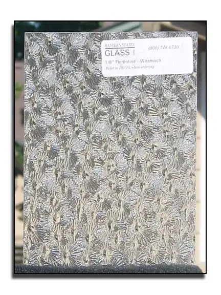

I found this site which lists many different styles of textured glass.
I think the particular one you had is somewhat close to the Florentine Wissmach on that site.

    Thank you so much. That is the exact pattern. I had been looking under Google under 'frosted glass'. Seems that textured is a more appropriate keyword. Now to see where I can buy some! – gbro3n Oct 20 '14 at 06:50
    And have now found a supplier for the replacement - note this is also known as 'Muranese' http://www.creativeglassguild.co.uk/prod/muranese-clear – gbro3n Oct 20 '14 at 09:46

Art glass suppliers offer similar reproduction patterns, often named Florentine. Florentine was actually a similar pattern from the USA, dating back to circa 1895. Whilst similar to Muranese, Florentine has a less dense floral cluster, with banding (parallel lines) incorporated.enter image description here
