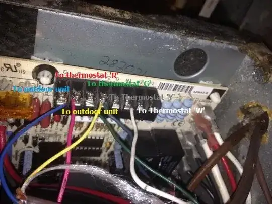

I will attempt to include photos of the AHU and Existing Thermostat terminal blocks:
AHU:

I've labeled your photo, which should help you understand what's going on.
What you describe as a "blue" wire at the thermostat, you describe as "gray" at the air handler. I can't be sure, since I'm not there, but I think they are one in the same.
If you want to install a fancy new WiFi thermostat, you're going to have to pull an additional wire from the air handler to the thermostat. Once you have that, you'll connect one end to the C terminal of the air handler, and the other end to the C terminal of the thermostat.

  • Thanks! I'll double check when I get home, I was pretty sure the wire at the Y terminal of the thermostat was blue as well, but the picture is kind of dark, maybe it is the gray wire from the Y terminal at the AHU. That would make more sense, not sure how it would be working if the C was connected to Y... So I just need to run a new 18 ga wire for the C terminal connection between AHU and Thermostat? Is it ok to double up the connection at the C terminal on the AHU? Thanks again for the help! – Hugh Oct 21 '14 at 20:56
  • One more question, if I am going to through the trouble of running a new wire, would it be worth replacing the old wire with a 5 way wire bunch cable? It is a pretty straight shot down from the attic, I figure I could tie of one end of the new cable to the old one and pull it through fairly easily. May be easier than just trying to run a single strand to since I'll have somewhat of a pull string (the old 4 bunch cable). Thanks! – Hugh Oct 21 '14 at 21:04
  • Yes, if it's not too hard pulling a new cable that's the way to go. – Tester101 Oct 21 '14 at 21:30
  • And connecting 2 wires to the C terminal at the AHU block isn't a problem? – Hugh Oct 22 '14 at 01:23
  • You've got two wires connected to the `Y` terminal. It's quite possible that it's rated for two. – Tester101 Oct 22 '14 at 01:25
  • Well, I guess I'll find out. Worse case scenario it should just trip the breaker (hopefully), and I just re-wire the old thermostat. thanks again – Hugh Oct 22 '14 at 01:33
  • FYI, running the 5 strand wire with the double connection at AHU C terminal worked! Thanks for the advice! – Hugh Oct 22 '14 at 04:20
