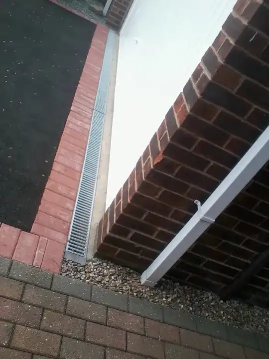

1) How effective is a french drain that is so close to the wall as in the picture below: enter image description here Below is a drawing (not mine) representing a french drain. Just to be clear, Our house does have gutters, clean and with no problems.

  • In your first question, that is not the type of French drain you're thinking of. That's just a drainage trench so that any water that washed down the lefthand surface will run into the drain instead of running through the door opening on the right of the drain. – rjbergen Oct 23 '14 at 14:12
    The first picture was provided just as an illustration, an example to how close the drain will be to the wall. That garage door has a channel drain which is not relevant for this discussion. – MiniMe Oct 23 '14 at 14:43
