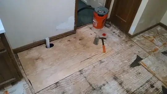

1) You need to lay down a layer of plywood. A half inch is good, but 3/4 in is better. IIRC, modern building code calls for 3/4 in. plywood. Screw it down and make sure there are minimal gaps. In the picture below, I had to replace a lot of plywood because some of it rotted through due to improper tiles laid before.
If you plan on any drains, toilet connections, or any other holes in the floor, try to figure out where they will be and make a approximate hole. If it's a little larger than it needs to be, it's not a big deal. Your plywood should be close but doesn't have to perfectly 100% nanometer precision fit your floor area.
Make sure your plywood doesn't move, creak, or slide around. If it does, rip it up and do it again so it doesn't. Bad subfloor = bad tile job = you fix it now, or you fix it in a few months/years.
Note: I took this picture part way through replacing the plywood. Laying Plywood

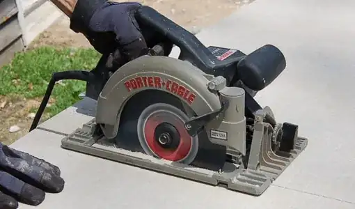

You will need to cut your hardie board to fit as close as possible your entire floor. It is easier to cut strait lines with a masonry circular saw blade. You can use a masonry blade on a handheld jigsaw to do more precise cuts. You can also score and snap cement board. Be careful though, cement board is brittle and it can snap easily, sometimes too much! (That means start over). Also, you don't want to line up the seams on your cement board with the seams on your plywood. Try to overlap them by at least a few inches if possible, and try to use large pieces of cement board, not 1,000 tiny pieces.
Skillsaw on cement board
IMPORTANT!!!! Cement board cutting makes a lot of dust. It goes everywhere. I recommend cutting OUTSIDE!

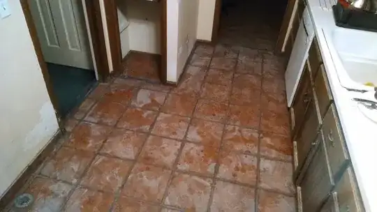

After cementing
Once you finish laying all the tiles, let it dry for 24 hours. Don't walk on it for at least 16, and avoid any heavy traffic.
