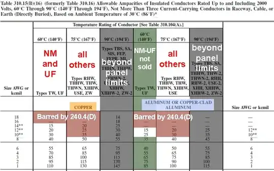

For AC power wiring, you just follow your electrical codes.
Here's my cheat sheet for NEC.
This is just the standard NEC table with the "no go zones" grayed out.
Note that the green zone (aluminum NM and UF) is found in old work, and apparently is starting to be sold again, go figure. Someone makes a Copper Clad Aluminum NM cable. Wish they would offer it in SER instead, so we could use the higher amp rating.
If your wire and all your terminals are rated for 75C thermal rating, you can use the 75C column (barring 240.4(D)), otherwise you use the 60C column.
