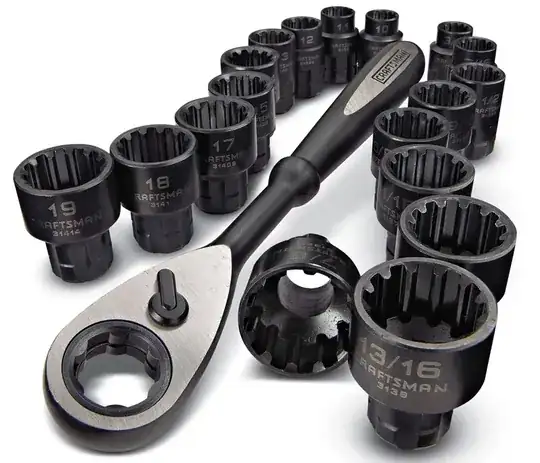

Another, Craftsman Max Axess with fits-all spline drive (hex, square, 12-point, spline, torx). You can get the matching power ratchet from them.
They don't tend to catch on for general use as you can't just pick up a standard ratchet, tee handle, L-bar, torque wrench, speed driver or extension and use them, plus finding an air ratchet to drive them is impossible unless provided by the manufacturer and you're just not going to be using them on an impact wrench.
