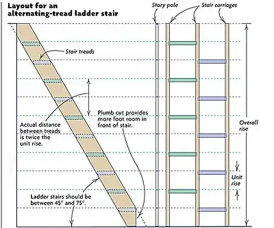

If you can't get any extra space, you might consider a "ladder staircase" (kind of a hybrid of ladders and stairs):
There are some interesting designs for these, including alternating treads:

    Alternate-tread stairs are very good things for small spaces. Unfortunately in many areas they don't meet code for occupied spaces -- check with your Local Authority Having Jurisdiction. – keshlam Jul 10 '14 at 13:25
